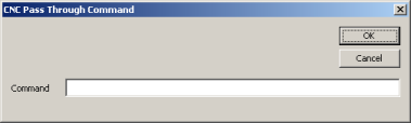

Select Operation | CNC Programming | Pass Thru to open the CNC Pass Through Command dialog box.
CNC/PASSTHRU,CommandString
This command string is inserted in line in the generated NC measurement routine. It may be any text string, but should represent valid commands for the controller. No syntax checking is performed in PC-DMIS.
CommandString Text string to be inserted into NC measurement routine.
