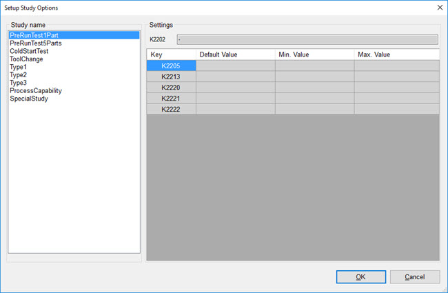

To open the Setup Study Options dialog box, select Setup | Study Options.
From the Study
name area, select a study. The K-fields associated with that
study open in the Settings area.
To view a description of a K-field, position your mouse pointer over
the field in the Key column.
Click a cell in the Default, Min. Value (minimum value), or Max. Value (maximum value) column to edit the value in it for the selected row.
You cannot modify values in rows that are unavailable.
Type the desired value.
To save your changes, click OK.
