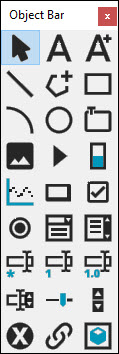

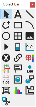

La barra degli oggetti può essere di uno dei seguenti tipi, uno per ciascun ambiente di modifica:
Editor dei modelli dei rapporti
Editor dei modelli delle etichette
Editor dei rapporti personalizzati
Editor dei moduli
Bitmap Object Analysis Object Pointer Object OLE Object Label Object GridControlObject Dimension Color Key Object TextReportObject CadReportObject ActiveX Object Ellipse Object Arc Object Pointer Object Text Object Line Object Leader Line Object Border Object
Bitmap Object Pointer Object OLE Object Label Object GridControlObject ActiveX Object Graph Object Gauge Object Ellipse Object Arc Object Pointer Object Text Object Line Object Leader Line Object Border Object Label Object Label Object
Bitmap Object Pointer Object OLE Object Label Object Label Object GridControlObject CadReportObject ActiveX Object Graph Object Gauge Object Ellipse Object Arc Object Pointer Object Text Object Line Object Leader Line Object Border Object Label Object Label Object Label Object Label Object
Spinner Object Slider Object Multi Edit Box Object Edit Long Box Object Edit Box Object Edit Double Box Frame Object Ellipse Object Arc Object Gauge Object Pointer Object Bitmap Object ActiveX Object Border Object OLE Object CadImageObject TextVar Object Line Object Leader Line Object Text Object Pointer Object Check Button Object Button Object Graph Object List Box Object Combo Box Object Radio Button Object
