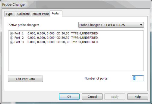

Select the Ports tab in the Probe Changer dialog box (Edit | Preferences | Probe Changer).
In the Active probe changer list, select TYPE=FCR25.
In the Number of ports box, in multiples of three, specify the number of ports your FCR25 Probe Changer is to have. PC-DMIS then lists the specified number of ports as "ports" (for example, port 1, port 2, port 3, and so forth). Until you define the ports, these "port" entries display as "UNDEFINED". You must define all of the ports in the rack before you start.
Ports tab with undefined ports

Repeat steps 4 through 6 for all ports in your changer.
Ports tab
To save your changes, click Apply.
