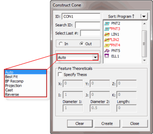

Construct Cone dialog box
PC-DMIS allows several methods for constructing a cone. The following table lists the various types of constructed cones, along with their necessary inputs. Some features may require no inputs while others may require six inputs or more. The term "Any" in the table below indicates that the construction can take any type of feature as input for construction. PC-DMIS allows you to select the features in any order.

To construct a cone:
Select Insert | Feature | Constructed | Cone to display the Construct Cone dialog box.
Input the desired features.
Select the method of construction. Available options include:
Best Fit or Best Fit Recompensate Cone
Cast Cone
Projected Cone
Reversed direction Cone
Auto Cone
Click the Create button.
