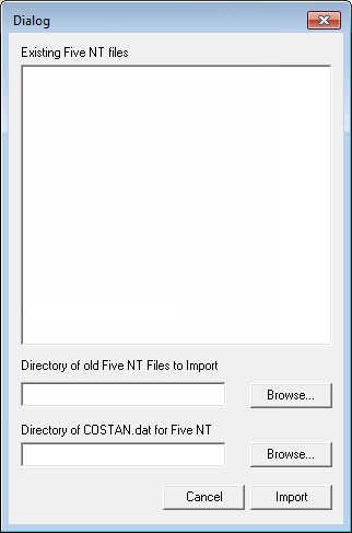

Five NT dialog box
The Five NT dialog box allows you to specify the files that define the System V (DCC) fixturing files that you want to import. Follow these steps to import fixturing files:
Select the File | Import | Five NT menu option to import DCC fixturing system data.
Browse to the Directory of old Five NT Files to import to specify the path of the Five NT file that you want to import.
Browse to the Directory of COSTAN.dat for Five NT to specify the location of the COSTAN.dat file to be used with Five NT.
From the Existing Five NT files list box, from the total list of available files, select the fixturing files to import.
Click the Import button to import the selected files.
The imported system is now ready for you to configure and use with PC-DMIS.
