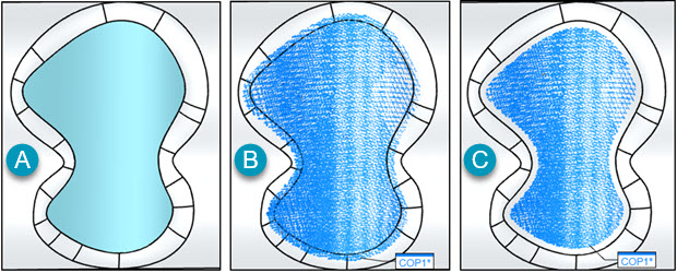

CAD Controls - If you select the Select check box, you can click specific CAD surfaces in the Graphic Display window to apply the Clean operation. The software highlights the selected surfaces in red. The operation affects the entire cloud of points on the selected surfaces. PC-DMIS discards any point located at a distance greater than the specified Max distance from all selected surfaces. For example, suppose you select a single surface and enter a value of 10. This means that the software cleans any point in the COP located 10 or more units away from the selected surface. Any point in the COP within 10 units of the selected surface remain.
With the Select check box selected, the CAD Offset check box becomes available. Select the CAD Offset check box to enable the CAD Offset input box. Enter a value that PC-DMIS uses to "shrink away" from the CAD edges. This allows you to isolate points relative to specific CAD faces, and ignore points along the edge within this fixed offset distance.
Example using the Clean operator with the Max Distance and CAD Offset options
A - CAD Surface selected in the Graphic Display window
B - Clean operation applied with a Max Distance of 1mm
C - Clean operation applied with a Max Distance of 1mm, and a CAD Offset of 1mm

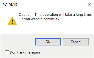

With the COPCLEAN function, if you select a large number of CAD faces, and you marked the Select option and entered a CAD Offset value in the CAD Controls area of the Pointcloud Operator dialog box, PC-DMIS displays this message:
The message indicates that if you click OK to perform the CAD Offset operation with the current settings, it will take PC-DMIS a very long time to process due to the large number of CAD faces you picked.
Select the Don't ask me again check box to prevent the message from appearing again.
Click OK to continue the operation, or click Cancel and the software will not execute the operation.
