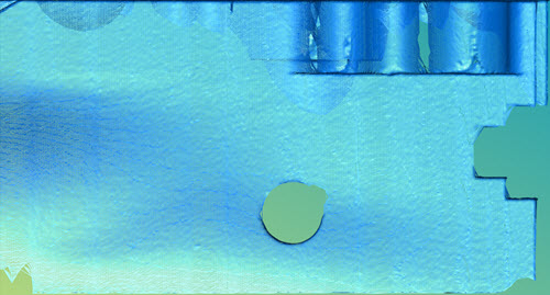

Stitch Patches check box - When scanning as Mesh display and the Stitch Patches check box is marked, multiple scan passes are blended and the overlapping data is removed.
(A) - Scan Pass 1
(B) - Scan Pass 2
(C) - Stitched area
The overlapping scan passes must be within a distance lower than the point density in order to be stitched.
Example of Stitch Patches turned ON when scanning as Mesh display

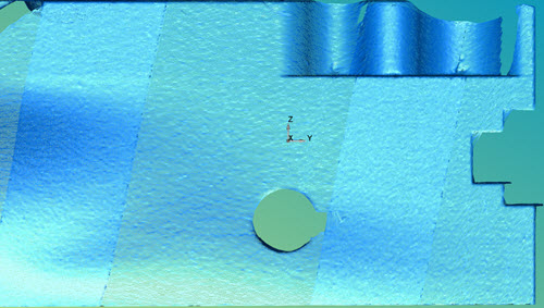

When scanning as Mesh display and the Stitch Patches check box is NOT marked, multiple scan passes are overlayed on top of each other.
Example of Stitch Patches turned OFF when scanning as Mesh display
