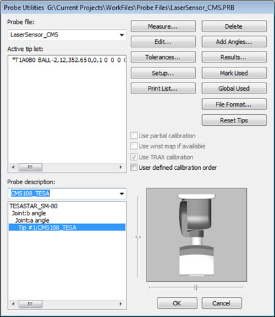

  1. Select the Insert | Hardware Definition | Probe menu option to open the Probe Utilities dialog box. (This dialog box automatically appears whenever you create a new measurement routine.)
  2. In the Probe file box, type a name that best describes your laser sensor.
  3. From the list of components at the bottom, select the No probe defined text to highlight it.
  4. From the Probe Description list, select the appropriate probe. Most laser sensors connect directly to the PH10M probe head. A CMS108 sensor that you use with a DCC machine connects to a Tesastar probe head. You can mount the CWS or WLS sensor on a wrist with a TKJ connector, or on OPTIV_FIXED on multi-sensor machines.
  5. As needed, select additional components in the same manner for "empty connections" until you finish defining the probe. A defined probe shows a tip in the Active Tip List.
