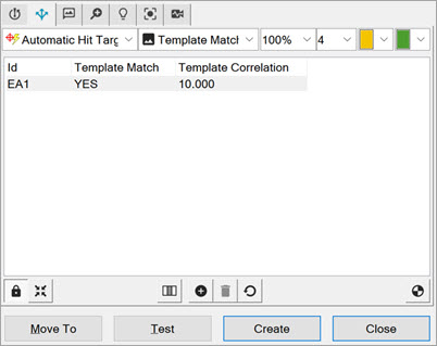

Enable Template Match from the Parameter Set list.
When you enable Template Match, the software inserts two new overlays:
Template Correlation
Template Correlation - This defines the minimum matching percentage. While PC-DMIS is performing a template match, the software searches for the position in the Search Area to locate the best match based on the defined template. The Template Correlation value defines the best possible match. For example, if there is an exact template image within the Search Area, then the correlation value is very close to 100%. It will probably never be 100% due to slight image variations and calculation rounding errors. If the correlation value of the best match is greater than the Template Correlation value you defined, then the template match is successful; otherwise, the template match fails. If the template match fails, PC-DMIS displays a message to indicate it in the Execution dialog box.
