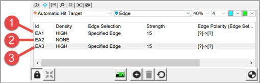

The resulting targets are defined in the Probe Toolbox of the Auto Feature dialog box for your Line feature.
Results of hits in the Probe Toolbox
In the image above:
1 - Target is defined from clicks 1 and 2
2 - Target is defined from clicks 2 and 3
3 - Target is defined from clicks 3 and 4
As each active target is generated, automatic execution is performed.

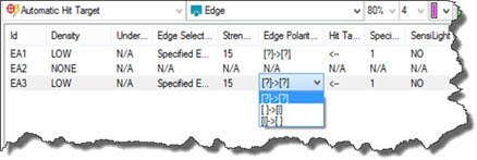

  1. Click in each of the Edge Polarity fields to change the settings as necessary.
Changes made to the last Active Target causes the automatic execution to restart.
