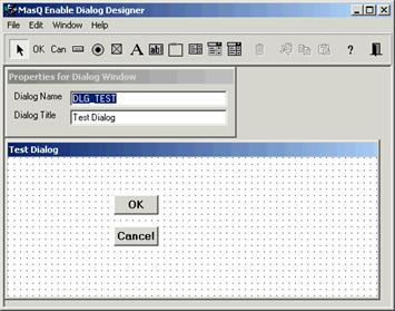

The Dialog Editor menu option launches the MasQ Enable Dialog Designer:
This application allows you to design dialog boxes for use with the Basic Script Editor. While it doesn't have the full power of a Visual Basic form designer, it provides you with a quick way to generate and place dialog box code into the Basic Script Editor.
For additional information on the Cypress Enable dialog box code, see the "Dialog Support" topic.
