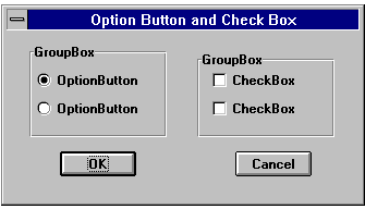

You can have option buttons to allow the user to choose one option from several. Typically, you would use a group box to surround a group of option buttons, but you can also use a group box to set off a group of check boxes or any related group of controls.
Example 1
Sub Main
Begin Dialog GroupSample 31,32,185,96,"Option Button and Check Box"
OKButton 28,68,40,14
CancelButton 120,68,40,14
GroupBox 12,8,72,52,"GroupBox",.GroupBox1
GroupBox 100,12,72,48,"GroupBox",.GroupBox2
OptionGroup .OptionGroup1
OptionButton 16,24,54,8,"OptionButton",.OptionButton1
OptionButton 16,40,54,8,"OptionButton",.OptionButton2
CheckBox 108,24,45,8,"CheckBox",.CheckBox1
CheckBox 108,40,45,8,"CheckBox",.CheckBox2
End Dialog
Dim Dlg1 As GroupSample
Button = Dialog (Dlg1)
End Sub

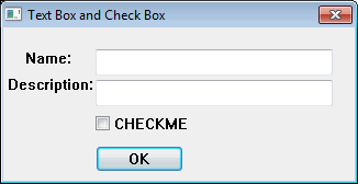

Example 2
Sub Main
Begin Dialog DialogName1 60, 60, 160, 70, "Text Box and Check Box"
Text 10, 10, 28, 12, "Name:"
TextBox 42, 10, 108, 12, .nameStr
TextBox 42, 24, 108, 12, .descStr
CheckBox 42, 38, 48, 12, "&CHECKME", .checkInt
OKButton 42, 54, 40, 12
Text 2,22,44,12, "Description:"
End Dialog
Dim Dlg1 As DialogName1
Dialog Dlg1
MsgBox Dlg1.nameStr
MsgBox Dlg1.descStr
MsgBox Dlg1.checkInt
End Sub
