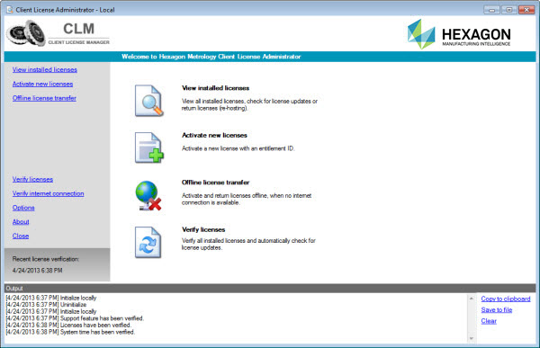

Use the appropriate desktop shortcut created with the software installation to start the CLM application on the computer you are licensing:
The "CLM Admin" shortcut is for node-locked licenses.
The "CLM Admin Server" shortcut is for floating licenses.
Select Offline license transfer from the CLM dialog box's main area, or from the menu on the left.
You must use the correct CLM Administrator tool described in step 1 to select the .clmresp file. Select Activate new licenses from the next dialog box, and then click Select Response.

To verify your license is activated:
Click the View Installed Licenses option in the upper-left of the CLM Admin application to see a list of all installed licenses.
Connect to the Internet, and then click the Verify Licenses option on the left of the CLM Admin application. The dialog box shows a list of licenses that are not activated.
