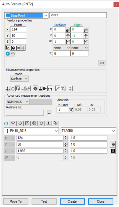

The Edge Point auto option allows you to define a point measurement that is to be taken on the part's edge. This measurement type is particularly useful when the part's material is thin enough that a precisely controlled CMM measurement hit is required. Five sample hits are needed to accurately measure an edge point.
To access the Edge Point option, open the Auto Feature dialog box for an Edge Point (Insert | Feature | Auto | Point | Edge).
Auto Feature dialog box - Edge Point

The dialog box displays the value of the selected edge point and vector
once the point has been indicated. The direction of the surface normal
vector is determined by the side of the part that is accessible to
the probe. If both sides of the part are equally accessible, the normal
from the CAD data is used. The Flip Vector
icon () on the dialog box lets you change the direction
of the approach.
Click Create to insert the feature into the measurement routine. If additional mouse clicks are detected before you click the Create button, PC-DMIS overwrites the previous information with the new data.
