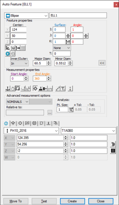

The Ellipse auto option allows you to define an ellipse. The ellipse feature type works much like the sheet metal circle feature. It is particularly useful when the ellipse is positioned in a specific plane that is not parallel with any of the workplanes. It is also useful if equally spaced hits are required for partial ellipses. The minimum number of hits required to measure an ellipse is five.
To access the Ellipse option, access the Auto Feature dialog box for an Ellipse (Insert | Feature | Auto | Ellipse).
Auto Feature dialog box - Ellipse

To generate an ellipse measurement using surface data with the CMM, take a minimum of five hits on the ellipse. PC-DMIS pierces the CAD surface closest to where the probe touched. The displayed X, Y, Z values reflect the closest CAD ellipse, not the actual hits. The I, J, K reflects the surface normal vector. If a CAD ellipse is not found, PC-DMIS displays the closest point and asks that additional points be taken.

Verify that the correct feature has been selected. The probe approach is always perpendicular to the feature, as well as perpendicular to the current probe centerline vector. The dialog box displays the value of the selected ellipse's center point and diameter once the wire has been indicated.

PC-DMIS uses the data to calculate the sheet metal ellipse. Additional hits can be taken until the Create button is clicked. The X, Y, Z that is displayed is the calculated center of the ellipse. Also shown are the calculated major and minor diameters, along with the orientation vector.

This method allows you to type the desired X, Y, Z, I, J, K values for the ellipse. In addition, the major and minor diameters of the ellipse as well as the angle vector I2, J2, K2 may also be keyed in.
Type the desired X, Y, Z, I, J, K values for the feature into the dialog box.
