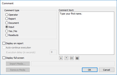

Insert an Input Comment
An Input comment collects information from the operator and stores it in a variable.
Select Insert | Report Command | Comment to open the Comment dialog box.
From the Comment type area, select the Input option.
In the Comment Text box, type this text: Type your first name.
Comment dialog box with an Input comment
Click the OK button to close the Comment dialog box. PC-DMIS displays a COMMENT/INPUT command in the Edit window.
The comment has an ID of C1. During execution, the C1.INPUT variable holds the value that the operator types into the Input dialog box.

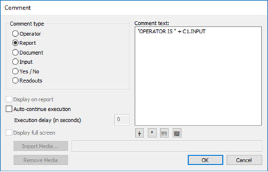

Insert a Report Comment
A Report comment sends information to the report.
In the Comment Text box, type this text to use the variable from the earlier input value: "OPERATOR IS " + C1.INPUT
Click the OK button to close the Comment dialog box. PC-DMIS displays a COMMENT/REPORT command in the Edit window.
