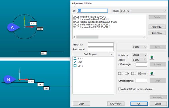

  11. Click the Origin button. This action moves the origin to the center of the circle and keeps it at the level of the plane. You can see that the trihedron moves in both the Z+ and Y- views and is fixed in place. This indicates the position of the new alignment.
At this point, the Alignment Utilities dialog box and Graphic Display window should look similar to what's here:
At left - Graphic Display window with trihedron in A) Z+ view and B) Y- view
At right - Alignment Utilities dialog box with the current alignment
When you complete the above steps, click OK to insert the alignment into the Edit window:
Edit window with the new alignment
