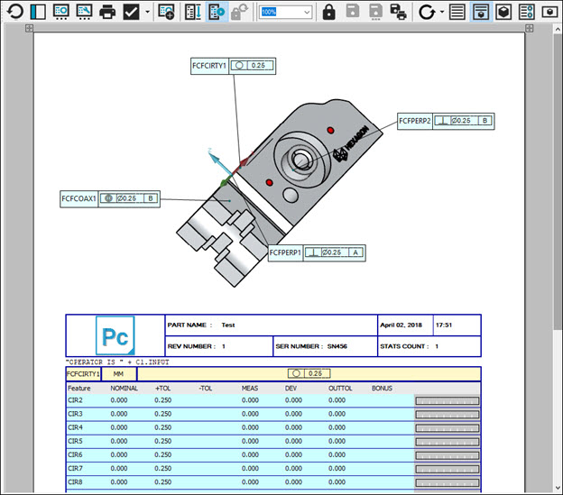

After PC-DMIS executes the measurement routine, it automatically prints the report to the designated output source that you specify in the Output Configuration dialog box (File | Printing | Report Window Print Setup). Because you chose the PDF output in a previous step, the report is sent to a PDF file in the same directory as the measurement routine.
You can also select View | Report Window to view the final report inside the Report window. With the Report window, you can display variations of the same measurement data when you apply different pre-made report templates provided with PC-DMIS. You can also right-click on different areas of the report to toggle the display of available items.

Sample report showing the four dimensions in the Text and CAD report
