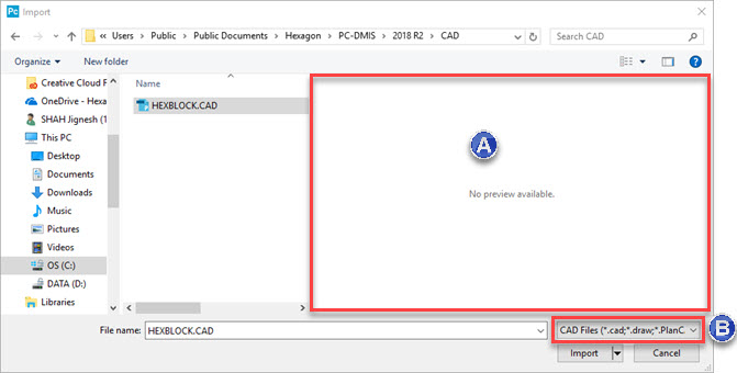

Once you select a menu item, the software displays an Import dialog box so that you can choose the file to import.
The dialog box is a standard Windows Import dialog box with the following additions:
Example of Import dialog box for CAD
Preview - This area of the dialog box shows the CAD image for .prg files. This area remains blank for all the other type of files.
This file type list displays the various file types that you can import. You can import any of these file types:
