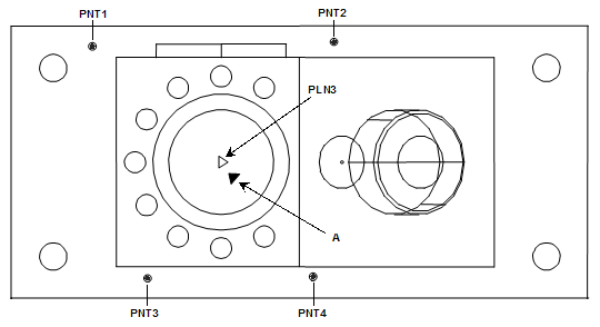

A - Best fit plane constructed from four points (PNT1, PNT2, PNT3, and PNT4)
Constructing a plane from three or more points
