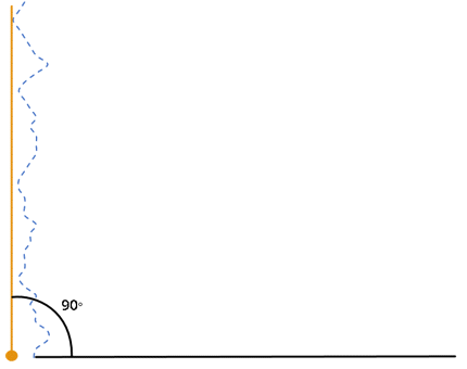

Case 1 - 90 Degrees (Orthogonal)
The yellow tertiary datum point below is constructed from the highest input point (where the yellow line contacts the blue dotted line) that is relative to the basic angle (90 degrees) from the specified secondary datum line in the primary datum plane's workplane.
Constructed Tertiary Datum Point feature from a 90-degree basic angle

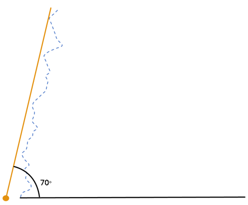

Case 2 - 70 Degrees (Non-Orthogonal)
Similar to Case 1, the yellow tertiary datum point is again constructed from the highest input point relative to the specified datums. This example shows how a non-orthogonal tertiary datum is created.
Constructed Tertiary Datum Point feature from a 70-degree basic angle
