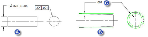

The Cylindricity form tolerance controls the shape of a cylinder feature without  controlling the size, orientation, or location. The surface of the considered cylinder must lie within a tolerance zone bounded by two concentric cylinders whose radii differ by the specified tolerance value. Cylindricity controls the circularity, straightness, and taper of the considered cylinder. Material condition modifiers and datum features are not allowed.
(A) If your drawing has this. (B) It means this. (C) A .001 wide tolerance zone.
