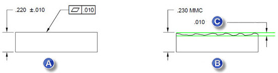

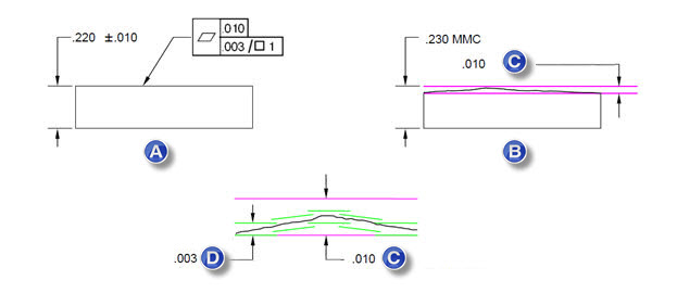

The Flatness form tolerance controls the shape of a planar feature without controlling the orientation or location. The surface of the considered plane must lie within a tolerance zone bounded by two parallel planes, which are separated by a distance equal to the specified tolerance value. In addition to overall flatness, you can also specify flatness on a unit area basis. Material condition modifiers and datum features are not allowed.
(A) If your drawing has this. (B) It means this. (C) A .010 wide tolerance zone.
Flatness of a Plane Per Unit Area
