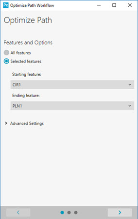

Step 1 - Set Options (Panel 1)
Panel 1 shows options you can select, as well as advanced settings.
Select Edit | Optimize Path,
or click Path Optimizer ()
from the QuickMeasure toolbar. This open
the Optimize Path Workflow dialog box and
changes the Edit window to show Command mode. For information on the
dialog box, see "The
Optimize Path Workflow Dialog Box".
Optimize Path Workflow dialog box (Panel 1)
On panel 1, from the Features and Options area, decide to optimize the path for all the features (All features) or a subset range of features (Selected features).
If you choose Selected features, from the Starting feature list, choose a start feature. You can also choose the feature directly from the Graphic Display window.
If you choose Selected features, from the Ending feature list, choose an end feature. You can also choose the feature directly from the Graphic Display window.
You can also open the dialog box with the starting and ending features already selected if you choose them first from the Edit window.
