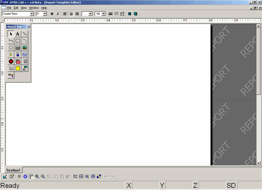

Select File | Reporting | New | Report Template to access the Report Template Editor. A blank report template automatically appears.
To hide any unused toolbars, right-click on the toolbar area and remove them.
To hide any unused PC-DMIS windows, select the open window from the View menu.
Click the maximize button
on the editor's window
to maximize the template editor. You should see the words "REPORT"
on the background of the editor, and your editor should have a
"Section1" tab at the bottom. Your Report Template Editor
should now look something
like
this:
Step 1: Report Template Editor

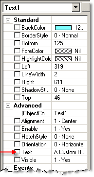

Select the Text object you created in the previous step.
Right-click on the object.
This causes the Properties dialog box
for that object to appear on the right side of the editor. On
the left side of the dialog box you will see
check
boxes next to most properties. These check
boxes determine what properties you can make user definable.
Sample Property Sheet for a Text object. Notice the user definable check boxes on the left.

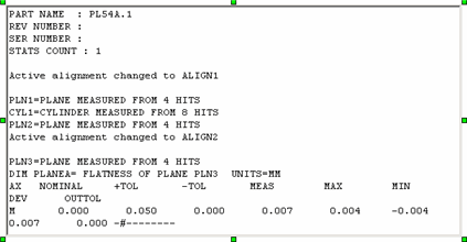

4: Add a TextReportObject
From the editor's Object Bar, click on the TextReportObject
icon
. Your mouse pointer will
change from an arrow pointer to a cross.
Add the TextReportObject on the template
by dragging a box on your template's section. PC-DMIS automatically
adds some default filler report text. When you apply this template
to your report, PC-DMIS will use your actual report data. This
filler text simply helps you understand what your design will
look like. Your object should look something
like
this:
Sample TextReportObject
Size the object so that it's close to the width of the Text object you added earlier. You can size the object by clicking and dragging one of the green boxes (or "handles") surrounding the object.
Select the Text object you added earlier. Hold down the Shift key and select the TextReportObject. This selects both objects.
With both selected, use the Layout Bar, and click the appropriate Make Same Size and Align Center icons to make the objects the same width and to align them so that they are centered in between the left and right sides of the editor.
Your template should now have a TextReportObject on the first section.

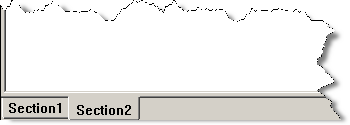

Right-click on the Section1 tab.
Select Add Tab from the shortcut menu. PC-DMIS inserts a new section, Section2, into your template.
Your template should now have two sections,
like
this:
Click on the Section2 tab to make that the active section.

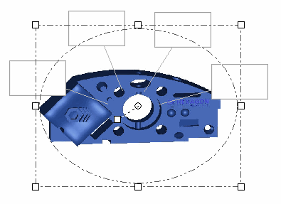

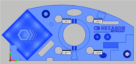

Add the CADReportObject on the template by dragging a box on your template's section. Size the box so that it measures about 6 inches wide and 4 inches tall. You can size the object by clicking and dragging one of the green boxes surrounding the object.
When you finish drawing the box, PC-DMIS automatically displays the Label Layout Wizard. This wizard shows a fake part surrounded by some fake labels. These dummy items are simply design aids while working in the template editor. You can use this wizard to set up labels around your part. For in-depth information, see the "The Label Layout Wizard" topic. When you apply this template to your report, PC-DMIS uses your actual CAD drawing and label information.
Change the Label Count box number of labels to 4.
Change the Layout Style to Elliptical Packed.
Click on the small, square, white handle in the middle of the CAD drawing, and drag the square clockwise or counterclockwise to rotate the labels along the elliptical path.
Rotate the labels until
all four are above the CAD drawing and the Layout
Preview area of the Label Layout Wizard
looks
like
this:
Layout Preview area showing four labels elliptically packed above the CAD drawing
Click OK. PC-DMIS inserts the object into Section2.

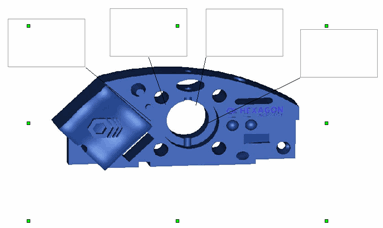

Your Section2 layout
should now contain a CADReportObject
looking something
like
this:
Example CAD report object showing the four dummy labels above the dummy part

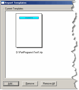

. The Report
Templates dialog box appears
Add your report to the Report Templates dialog box by clicking the Add button.
Navigate to and select
test1.rtp. Then click Open. PC-DMIS
adds a thumbnail view of your report into the Report
Templates
dialog
box.
Report Templates dialog box showing Test1.rtp
Select your template's
thumbnail icon, and click Open. PC-DMIS

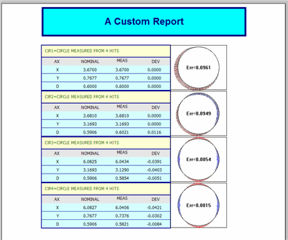

opens the Report window using your newly created template. It
like
this:
Report Window Showing Report Data Using the Test1.rtp Report Template
Finally, execute your measurement routine. The first time you execute the measurement routine using this report template, PC-DMIS will display a Define User Assigned Properties dialog box, asking you to give the report a new title and to set the background color.
Set these properties as desired, and click OK. The dialog box closes and PC-DMIS runs your measurement routine.
When execution finishes, PC-DMIS shows the report data with the new template.
