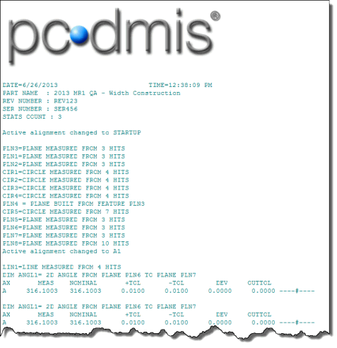

Report Window showing a legacy text report
This topic discusses how you can get a legacy (old style) text-only report to show up in your Report window. PC-DMIS version 3.7 and earlier used this report type.
