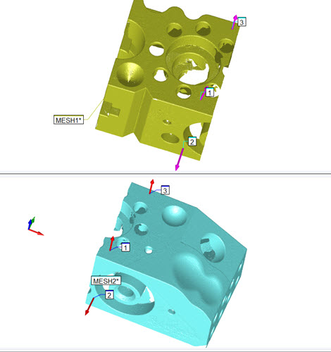

A temporary split-screen view of the two meshes appears in the Graphic Display window. You can use this view to visually see the alignment taking place. Select the first Mesh used as a point of reference from the Reference drop down list.
Split-screen view showing a mesh to mesh alignment
Use your mouse to manipulate and orient each view as needed to create the Point Pairs.

If the auto compute does not compute a good alignment, use the Point Pairs area to perform a rough alignment that brings the meshes close enough to each other. You can then refine the alignment further if needed. You should use this type of alignment if the mesh is not complete or it contains scanned data belonging to a fixture, table, or other similar feature.
Click a desired
number of points (at least three pairs) on each of the meshes on the
overlap area. ONLY click points on the overlap area of the two meshes.
The more points you take around the overlap area of the meshes results in an improved alignment. Click Compute to create the rough alignment.
