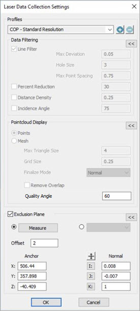

Access the Laser Data Collection
Settings dialog box (Operation | Pointcloud
| Data Collection) or click the Pointcloud Data
Collection Parameters button () on the
Pointcloud
toolbar or QuickCloud
toolbar.
Laser Data Collection Settings dialog box
The Laser Data Collection Settings dialog box allows you to select, define, and save scan profiles. You can also define the exclusion plane and the pointcloud display for laser scanned data.
You can click the Collapse
button to hide sections
of the Laser Data Collection Settings dialog
box or click the Expand button
to display hidden sections
of the dialog box.
