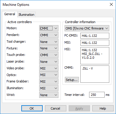

When you first start PC-DMIS after you install it, you should run it with administrator privileges. This ensures that the software properly initializes the registry entries and the correct settings for the active controllers in the Machine Options dialog box (Edit | Preferences | Machine Interface Setup):
For a laser probe (CWS or TTL), select CMMI in the Laser probe list. Otherwise, select None.
For a touch probe, select CMMI in the Touch probe list. Otherwise, select None.
