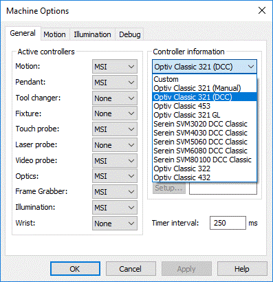

When you first run PC-DMIS after installation, you must configure the machine settings from the Machine Options dialog box.
To do this:
From the Machine Options dialog box (Edit | Preferences | Machine Interface Setup), select the General tab and configure the correct settings in the Active controllers area.
Machine Options dialog box for Metronics setup
From the Controller information area, select the machine type (for example: Optiv Classic 321 (DCC)).
Click Apply and then OK to save your changes.
