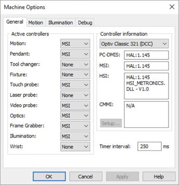

You must then configure the interface in the Machine Options dialog box (Edit | Preferences | Machine Interface Setup):
