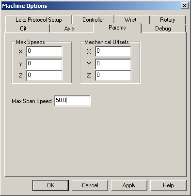

Machine Options dialog box - Params tab
Max Speeds - These values are the maximum speeds for the X, Y, and Z axes. Normally these values are read from the controller.
Mechanical Offset - These values allow you to establish the mechanical offsets for your XYZ axes for your machine. Volcomp is normally performed in the controller itself with this interface. If for any reason it was configured to require a probe reference point other than 0,0,0, the values can be input in these offsets.
Max Scan Speed - This value sets the maximum allowed scan speed. This is only used for analog scans such as that with an SP600 probe or WAB optical probe.
Altering these values may give an undesired result. Only a trained Technician should change these values.
