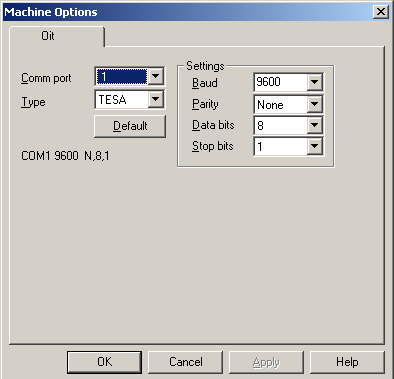

Machine Options dialog box - Oit tab
The Oit tab allows you to configure the serial connection that connects to your OIT device. You can choose your communications port (COM port) and modify your COM port settings. For information on your COM port settings, check the documentation that came with your controller. The available OIT types are TESA, VORNE, or GE.
