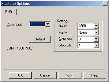

Machine Options dialog box - PH9 tab
The PH9 tab allows you to configure the serial connection that connects to your PH9 device. You can choose your communications port (COM port) and modify your COM port settings. For information on your COM port settings, check the documentation that came with your controller.
