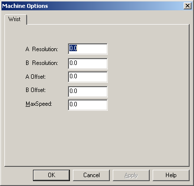

Machine Options dialog box - Wrist tab
The Wrist tab allows you to specify the scale factor for the A and B axes of your wrist device in the A and B Resolution boxes respectively. The scale factor is used to convert values from your wrist device to consistent value in PC-DMIS.
The A and B Offset values are used to "square up" the home position of your continuous motion wrist.
The Max Speed box provides the maximum allowable speed (percent) for movement of your continuous motion wrist.
Altering these values may give an undesired result. Only a trained Technician should change these values.
