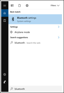

From the Windows Start menu, type bluetooth, and choose Bluetooth settings to access the Bluetooth settings in Windows.
