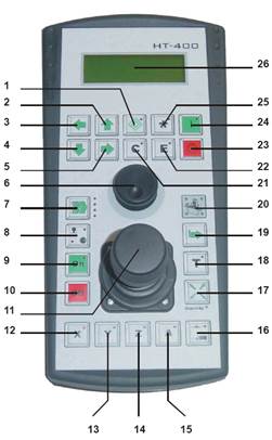

HT400 Jog Box
The SB-Elektronik jog box connects to the SB-Elektronik controller which sends scan codes to PC-DMIS.
SB-Elektronik HT400 Jog Box
No. | SB-Elektronik HT400 Key Function | PC-DMIS Function |
1 | Input Control | Insert Move |
2 | Input Control (Shift Key) | |
3 | Input Control | |
4 | Input Control | |
5 | Input Control | |
6 | Handwheel + Button (Sensor 5) | |
7 | Switch the Speed Stages | |
8 | Switching between Joystick and Manual Wheel | |
9 | Output Stage ON | |
10 | End Stage OFF | |
11 | Joystick + Button Optional (Sensor 4) | |
12 | ON/OFF Axis X | |
13 | ON/OFF Axis Y | |
14 | ON/OFF Axis Z | |
15 | ON/OFF Axis A | |
16 | Halve the Set Speed | |
17 | Operation Enable for HT | |
18 | Accept Restart Point | |
19 | Switch the HT Position | |
20 | Display the HT Position | |
21 | Input Control | Clear / Erase |
22 | Input Control | End/Enter |
23 | Stop Traversing Record | Hold |
24 | Start Traversing Record | Measure |
25 | Input Control | Cancel |
26 | Display |

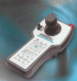

Wenzel HT400 Jog Box
The Wenzel HT400 jog box connects directly to the computer through a serial port which then sends scan codes to PC-DMIS.
Wenzel HT400 Key | PC-DMIS Function |
X | |
Y | |
Z | |
C | |
F1 | End / Enter |
F2 | Clear / Erase |
F3 | Insert Move |
F4 | Measure (or N/A) |
F5 | Cancel |
F6 |
