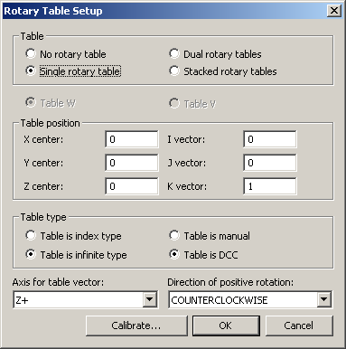

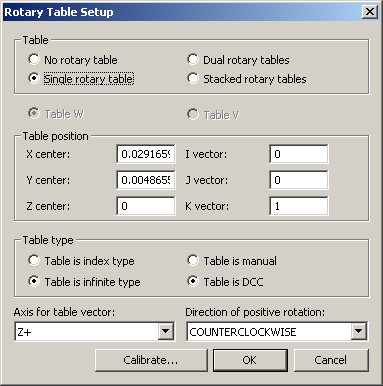

To open the Rotary Table Setup dialog box, select Edit | Preferences | Rotary Table Setup, and ensure that the Single rotary table option is selected. If you are calibrating from scratch, clear the offsets as shown below:
Rotary Table Setup Dialog Box

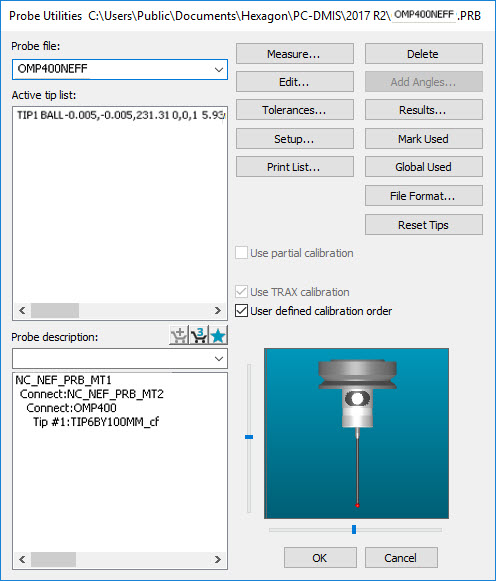

Use the Probe Utilities dialog box to select or create a tip:
Probe Utilities Dialog Box

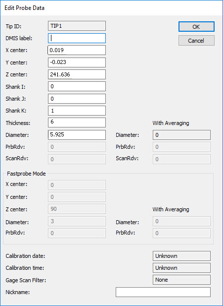

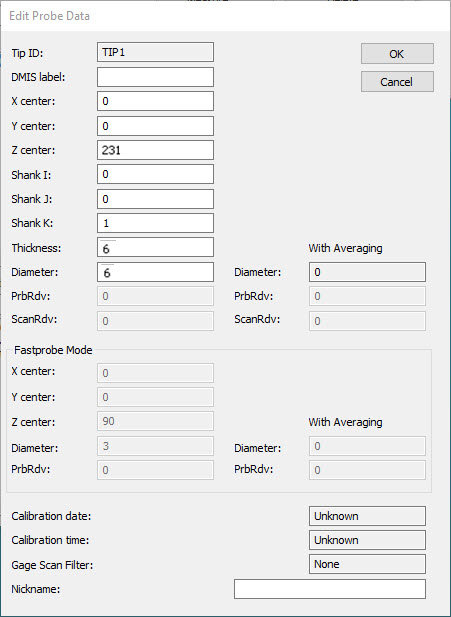

From the Probe Utilities dialog box, click Edit to view or edit the probe data. Click OK to accept any changes and return to the previous dialog box, or click Cancel to return without saving.
Edit Probe Data Dialog Box

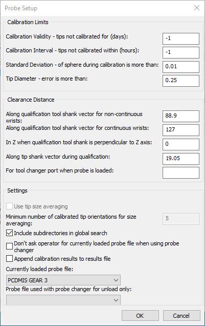

From the Probe Utilities dialog box, click Setup to view, edit, and set the probe setup values as necessary. Click OK to accept any changes and return to the previous dialog box, or click Cancel to return without saving.
Probe Setup Dialog Box

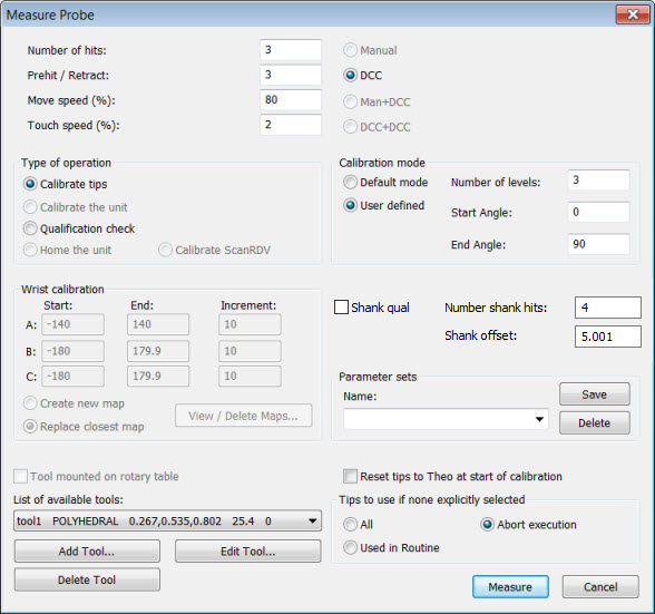

From the PC-DMIS Probe Utilities dialog box, click Measure, and select a ring tool as shown below:
Measure Probe Dialog Box

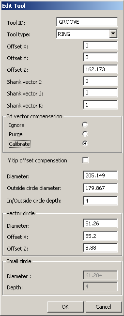

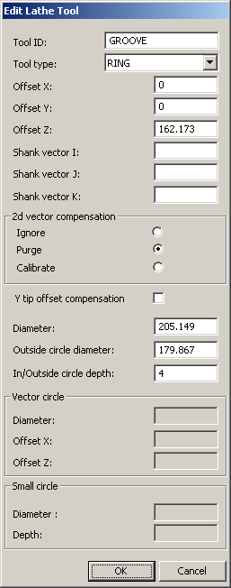

Click Edit Tool to update the groove parameters or create a new tool setup. The Edit Lathe Tool dialog box appears:
Edit Lathe Tool Dialog Box
From the data in the above image, PC-DMIS measures 4 mm deep into a groove at Z=162.173 mm with an outside circle of diameter 179.867 mm, an inside circle of diameter 205.149 mm, and a plane with an offset equal to the prehit distance beyond the 205.149 circle.

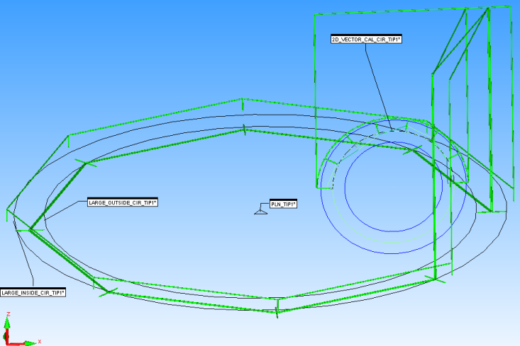

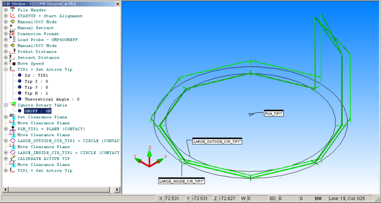

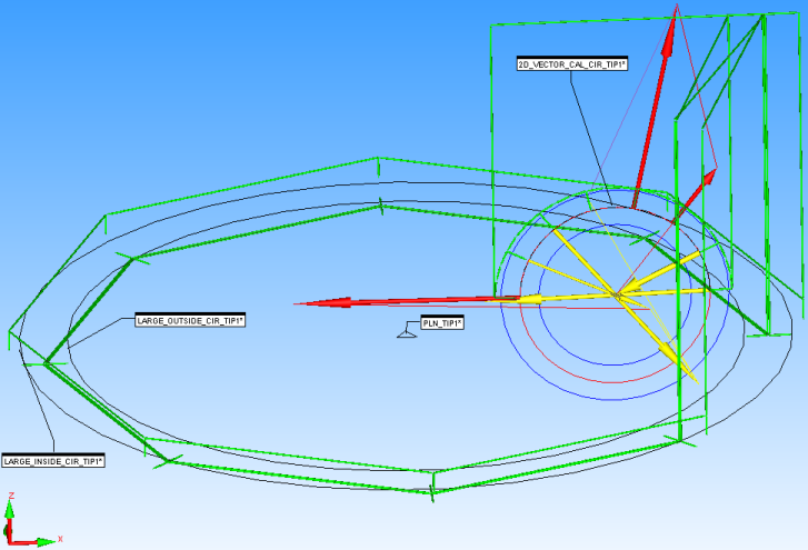

View the path lines, and check the path in the Graphic Display window as shown below:
Display of Groove Calibration Path Lines

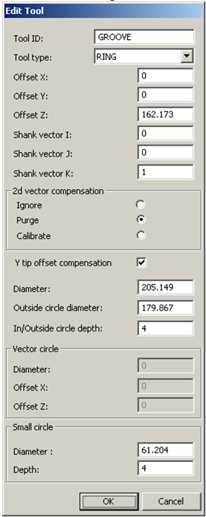

Edit Tool Dialog Box

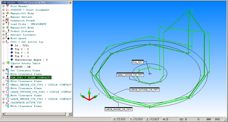

From the data in the above image, PC-DMIS measures 6 mm deep into a groove at Z=162.173 mm with an outside circle of diameter 179.867 mm, an inside circle of diameter 205.149 mm, a plane with an offset equal to the prehit distance beyond the 205.149 circle, and finally an optional inside circle of diameter 61.204. This latter circle is used if the probe Y offset is required.
After completion, click OK to return to the Measure Probe dialog box. Click Measure to create the calibration measurement routine in the Edit window. View the path lines, and check the path in the Graphic Display window as shown below:
Display of Groove Calibration Dialog Box with Optional Inside Circle

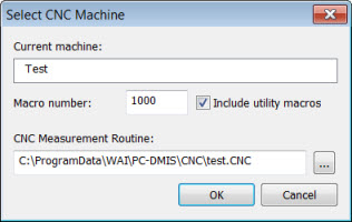

To create the CNC measurement routine, select Operation | CNC Programming | Create CNC Measurement Routine.
Select CNC Machine Dialog Box

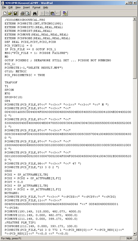

The CNC measurement routine file appears as shown below:
CNC Calibration Measurement Routine Output File
The default is now for non-circular moves inside the groove since circular motion is naturally achieved by the lathe.

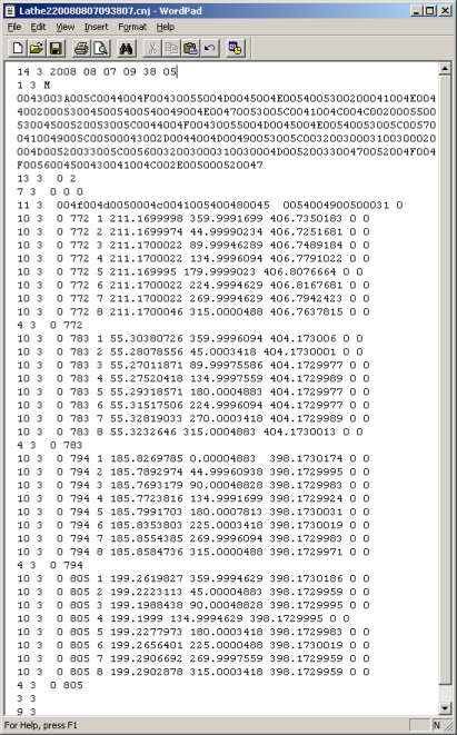

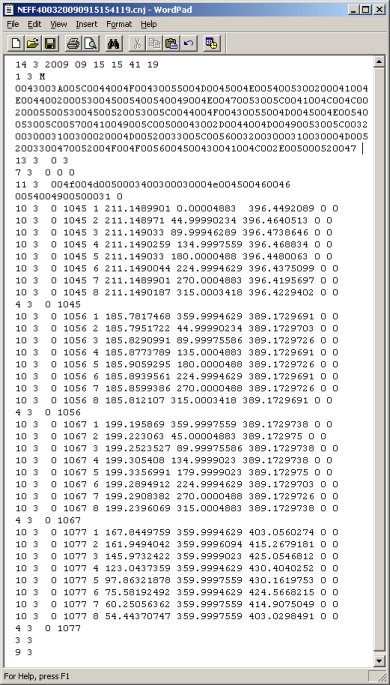

Copy the calibration measurement routine to the controller, and run it to produce a journal file as shown below:
This journal file has been adapted from data collected during testing of PC-DMIS Version 4.3 by copying over the file, machine, and feature number identification from the .mpf file generated by PC-DMIS version 2010.
CNC Journal Output File

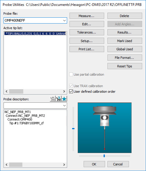

To verify that the probe calibrations have been updated, open the Probe Utilities dialog box:
Updated Probe Utilities Dialog Box
Click Edit to see the updated details.
For comparison, the first image below is an example of the calibration that uses all three circles:
The image below is an example of the difference seen when using just the two circles.
Comparison of Edit Probe Data Dialog Boxes

Navigate to the Rotary Table Setup menu option (Edit | Preferences | Rotary Table Setup) to see the updates to the probe tip offset from the rotation center:
Updated Rotary Table Setup Dialog Box

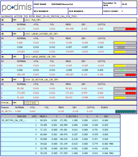

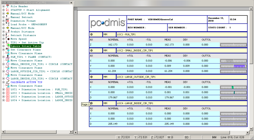

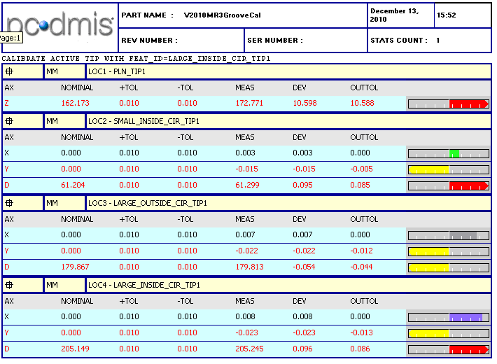

It is instructive to dimension the calibration measurement routine in PC-DMIS to produce a report. Shown below, the deviations come in red. This is because the nominals supplied are so far from true for this calibration artifact.
PC-DMIS Calibration Report Dialog Box
To do a sanity check, turn off Marking the Probe Calibration feature in the measurement routine, turn off the Ignore Rotary Table feature, and re-run the journal file as you would run a normal measurement routine to check if the results are near perfect as shown below:
Updated PC-DMIS Report Dialog Box

2D Vector Calibration has been added to the Groove calibration to compensate for out of roundness of the tip ball. Groove calibration only measures at three points on the tip, so this may be insufficient. Vector Calibration measures a number of points around a circular profile.

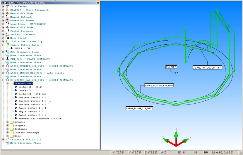

As an example, to use the profile of the torus described above, add the diameter of the circle in the Edit Tool dialog box in the highlighted position as follows, and add the X axis offset of the circle center in the last edit box in the dialog box:
Edit Tool Dialog Box for Vector Calibration

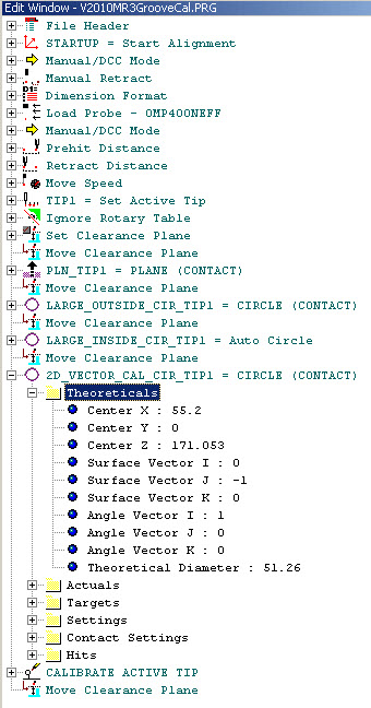

The generated measurement routine is shown below:
Generated measurement routine for Vector Calibration
This creates a calibration measurement routine as before, but with the addition of a profile measurement. This creates a look-up-table of vector versus tip radius.

Open the Probe Utilities dialog box (Insert| Hardware Definition | Probe) and verify that the probe calibrations have been updated:
Probe Utilities Dialog Box after Vector Calibration
Click Edit to view the new settings after the Vector Calibration is complete:
Edit Probe Data Dialog Box after Vector Calibration
Navigate to the Rotary Table Setup dialog box (Edit | Preferences | Rotary Table Setup) to see the update to the probe tip offset from the rotation center:
Rotary Table Setup Dialog Box after Vector Calibration

When you run saved journal files to calibrate and recalibrate with different options selected, make sure the tool dialog box matches too. For example, if you run a simple groove calibration measurement routine (with no second vector calibration) and the corresponding journal file, but the tool dialog box retains the values for the second vector circle, then a bad calibration results. This scenario does not apply when creating fresh calibrations on a machine, because the tool dialog box always matches where a fresh calibration measurement routine is created.
It is instructive to dimension the calibration measurement routine in PC-DMIS to produce a report. In this case, we are also interested in the circularity figure for the profile measurement:
PC-DMIS Report with Dimensioned Calibration Measurement Routine
