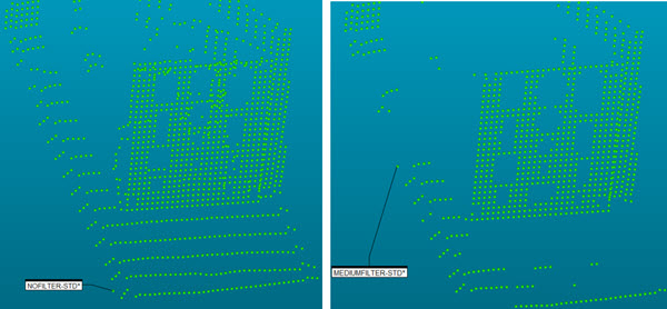

Use the Quality Filter option on the Surface Probe tab of the Machine Options dialog box to filter and remove measured points that were measured when the laser beam was partially on and partially off the part surface. PC-DMIS filters the points in real-time while it scans.
Select an option from the Quality Filter list to apply a filter setting to the data points. The default setting is Medium.
Example using the QualityFilter setting to None (left) and Medium (right)
