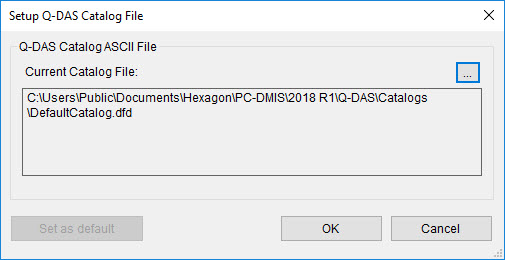

From Q-DAS Configurator, select Setup | Q-DAS Catalog File to open the Setup Q-DAS Catalog File dialog box.
The Current Catalog File box displays the name of the catalog file that is defined in the current Q-DAS data file.
When you initially install PC-DMIS, the default catalog file is DefaultCatalog.dfd. PC-DMIS uses this catalog until you define your own catalog.
If the default catalog file no longer exists on your computer, a red exclamation point appears.
To select an existing catalog, select the browse button and navigate to the catalog file.
Click the Set as default button to set the current catalog file as the default.
To save your changes, click OK.
