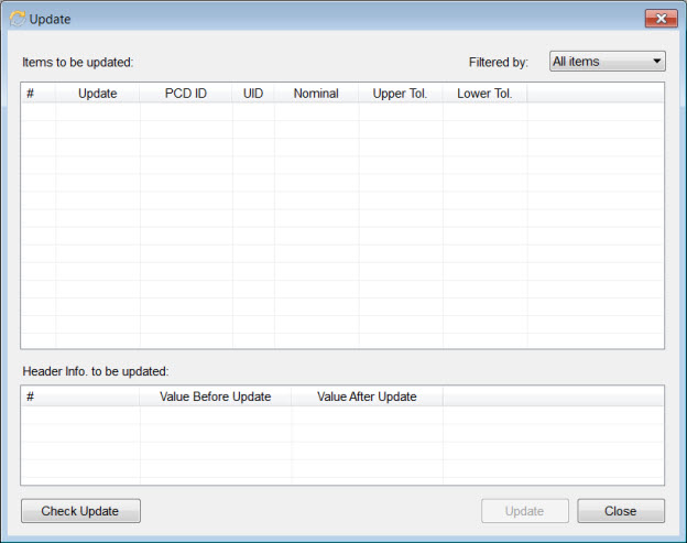

From Q-DAS Configurator, select File | Update to open the Update dialog box.
Update dialog box
Click Check Update. Q-DAS Configurator reads the measurement routine, determines the changes, and displays the changes in the dialog box. The processing time varies and depends on the size of the measurement routine.

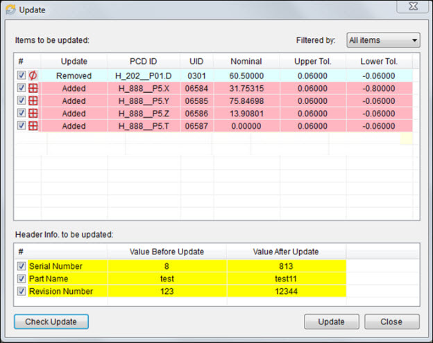

To filter the changes, select the desired option in the Filtered by list: All items, Added items, Removed items, or Modified items.
The Update column then displays the type of update. The changes in the header of PC-DMIS appear in the Header Info. to be updated area.

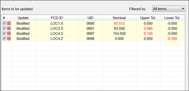

The values that you modified appear in red.
Example of modified values
If you want to view the data for an item before it was modified in the measurement routine or removed from the measurement routine, right-click on the modified or removed item in the Items to be updated area. A shortcut menu opens with a Locate option. When you click this option, the item becomes highlighted in the Characteristics data area.
Select the items that need to be updated and then click Update to complete the process.
