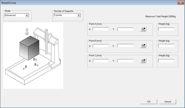

Use the Advanced mode for the WeightComp command to enter complete information about the workpiece's placement, support, and weight distribution.
To use this mode, do the following:
  1. In the Mode list, click Advanced. The following dialog box appears:
WeightComp dialog box - Advanced mode
  1. Complete the items in the dialog box.
Item
Description
Number of Supports area
From the list, select the number of support points on which the workpiece is loaded:
  • 3 points
  • 4 points - The graphic changes to the following:
Maximum Total Weight [units]
([units] reflects the current units set up for PC-DMIS: kg or lbs)
Maximum total weight read by the controller.
Point A [units] area
Point B [units] area
Point C [units] area
Point D [units] area (available only when Number of Supports is 4 points)
([units] reflects the current units set up for PC-DMIS: mm or in)
X and Y boxes - Enter the X and Y coordinates of the support points and the weight loaded on each support point.
If an X or Y box is blank, an error symbol Error symbol appears to the right of the box when you click OK. It indicates that a positive double value is expected. Enter the missing value.
Readout button
To automatically enter the current position in the X and Y boxes, position the CMM and then click this button.
Weight [units] area
Type the weight.

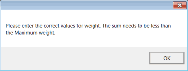

The sum of the weights for points A, B, C, and D must be less than or equal to the maximum total weight. If the sum is greater than the maximum total weight, a message appears when you click Apply and indicates that the sum needs to be less than the maximum weight:
Message about correct weight values
Type the correct weight(s) in the Weight [units] box(es).
