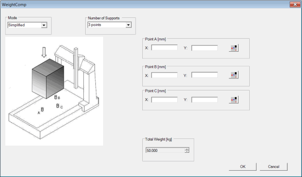

  1. In the Mode list, click Simplified. The following dialog box appears:
WeightComp dialog box - Simplified mode
  1. Complete the items in the dialog box.
Item
Description
Number of Supports area
From the list, select the number of support points on which the workpiece is loaded:
  • 3 points
  • 4 points - The graphic changes to the following:
Point A [units] area
Point B [units] area
Point C [units] area
Point D [units] area (available only when Number of Supports is 4 points)
([units] reflects the current units set up for PC-DMIS: mm or in)
X and Y boxes – Enter the X and Y coordinates of the support points.
If an X or Y box is blank, an error symbol Error symbol appears to the right of the box when you click OK. It indicates that a positive double value is expected. Enter the missing value.
Readout button
To automatically enter the current position in the X and Y boxes, position the CMM and then click this button.
Total Weight [units] area
([units] reflects the current units set up for PC-DMIS: kg or lbs)
Select the total weight of the workpiece. The range in the list starts at the minimum relevant weight for the weight compensation and ends at the maximum compensated weight.

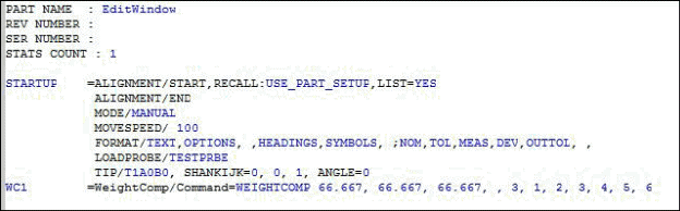

Here is an example of the Edit window for the Simplified mode:
Edit window for Simplified mode
Example of Edit window for Simplified mode
