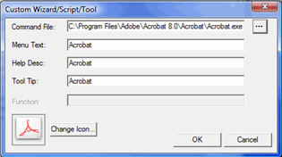

  6. Select the file to insert, and click Open. The Open dialog box closes and the Custom Wizard / Script / Tool dialog box displays the default information associated with the custom program you selected.
Custom Wizard / Script / Tool dialog box showing a sample application
Command File:
This box shows the pathway to the command.
Menu Text:
This box allows you to specify the name used on the menu for this item.
Help Desc:
This box allows you to define information that PC-DMIS displays in the status bar when you move your mouse over the item.
Tool Tip:
This box allows you to specify the tooltip text displayed for this item when you hover your mouse over it. This only works if the custom item is added to a toolbar, not a menu.
Function:
This box remains unavailable for selection unless you are using a custom BASIC script. Once the box becomes enabled, you can use it to define the function or subroutine that runs from the loaded .bas file. Type the routine name without parenthesis. For example, typing "TestFunction" launches the TestFunction routine when the BASIC script is executed.
Change Icon:
This button allows you to change the icons displayed for this menu item.
