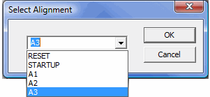

To export a specific alignment, from the Setup Options dialog box, first select the Select Alignment to Export check box. Then, when you export to a .gds file, the Select Alignment dialog box opens so that you can select an alignment.
