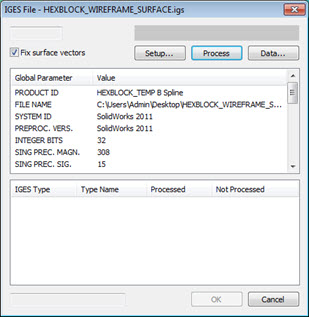

  2. Click the Import button. PC-DMIS displays the IGES File dialog box. The IGES File dialog box displays all of the pertinent information about the indicated data file.
  1. If you want your surface vectors to be correct and always point away from the surface, select the Fix surface vectors check box. This is helpful for pointcloud and laser scanning operations, but it does increase the import processing time. If you don't use laser scanning, you can clear this check box.
  2. If you want to determine the CAD data that PC-DMIS processes and displays, click the Setup button (for information, see "Altering Display of Imported IGES CAD").
  3. To view specific IGES feature data, click the Data button (for information, see "Using the IGES Data Dialog Box").
  4. To attach this file to the selected measurement routine, click the Process command button. PC-DMIS indicates when the file is 100% processed.

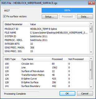

IGES File dialog box after a file is processed
  1. To complete the action, click the OK button. PC-DMIS displays the imported IGES model. Select the Cancel button to terminate the entire operation and close the IGES File dialog box.
