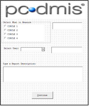

In this step, you have completed the basic form,
adding various controls and assigning items to lists. It should look
something
like
this:
Form with the various form controls added

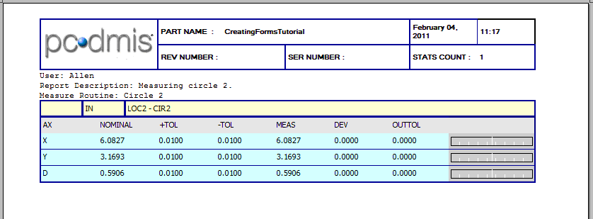

Select View | Report Window and use the Template Selection Dialog toolbar icon to set the report to use the default standard report template, TextOnly.rtp.

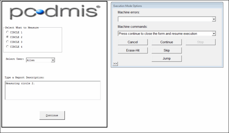

Return to the Edit window. Mark the entire Edit window, save your measurement routine, and then select File | Execute to test your measurement routine.
When PC-DMIS reaches the FORM/FILENAME command, it will run the form and pause execution until you finish filling it out.
Fill out the form and click the Continue button. PC-DMIS passes the values from the form back into the PC-DMIS variables.
The conditional statements check the value of the STR_MEASURE variable and execute the appropriate Circle feature accordingly.
PC-DMIS prints the report comments and the measured results for the measured feature to the Report window.
