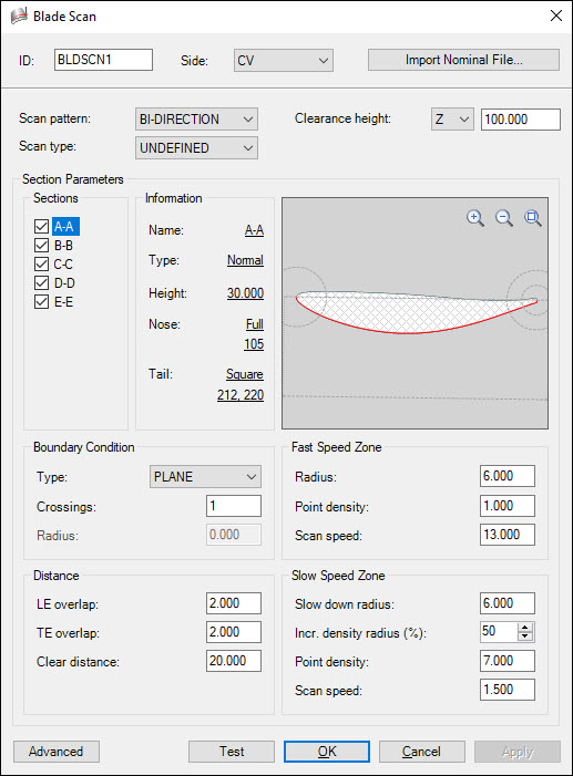

To create a Blade Scan command, do the following:
Select Insert | Modules | Blade Scan to open the Blade Scan dialog box. Here is an example:
Align the blade according to the CAD model in the View area. The nominal data is in this coordinate system.
Complete the items in the Blade Scan dialog box.
ID Box
Enter the name of this Blade Scan command in the ID box.
Import Nominal File Button
Use the Import Nominal File button to import the Nominal file for the blade. The PC-DMIS Blade Analysis software requires that a folder with the name "Blade" is created in the BladeRunner installation folder. You should place all of the relevant files in this folder. The names of all the files should be the same as the name of the folder. The Nominal file has the extension .nom and resides in the "blades" folder of the BladeRunner installation directory (usually C:\BladeRunner\blades).
PC-DMIS reads the Nominal file and displays the information from it in the appropriate parameters in the Section Parameters area. When you import the Nominal file, the Blade Scan command refers to the Blade Scan Lookup Table (BladeScan.LookupTable.xml) and inserts the suggested scan speed and point density for the chord length of the blade. You can then modify these parameters. For more information about the table, see "Modifying the Blade Scan Lookup Table".

Sections Area
The Sections area displays all of the section names in the Nominal file that you imported. The Blade Scan command scans only the blade sections that are selected in this area. By default, all of the blade sections are selected for scanning. If you do not want to scan a certain blade section, clear its check box. To select a blade section, click its check box.

Boundary Condition Area
Use the Boundary Condition area to describe how to identify the end of scanning. The parameters are:
Type box - Select PLANE or SPHERE.
Crossings box - Enter the number of crossings.
Radius box - If you select the SPHERE boundary condition, enter the radius of the boundary sphere.
The boundary plane vector is calculated by subtracting the end vector from the vector of the line joining the LE and TE points.
Distance Area
Use the Distance area to specify the distance the probe will over travel the start and end points to ensure that the scan on the CV side and the CC side overlap each other as required by the Blade Analysis software. The parameters are:
LE overlap box - Enter the distance for the LE.
TE overlap box - Enter the distance for the TE.
Clear distance box - Enter the distance in front of the blade section to which the probe travels before the measurement of the next section begins. The distance should ensure that the probe movement from the LE to the TE between sections is collision-free.
Fast Speed Zone and Slow Speed Zone Areas
The Fast Speed Zone area is the middle zone of the blade section. Typically, this zone is scanned at a higher scanning speed and has a low density of points.
The zones in the Slow Speed Zone area are near the trailing and leading edges. Typically, these zones are scanned at slower speeds and have a high point density.
Scanning usually uses the speed defined in the Slow Speed Zone area near the LE or TE. A high number of points are collected in the slow speed zone. After the probe crosses the value defined for the Slow Speed Zone Radius parameter, the scan speed increases to the speed defined for the Scan speed parameter in the Fast Speed Zone area, and points are collected at rate of the value defined for the Fast Speed Zone Point density parameter.
When the probe crosses the value defined for the Slow Speed Zone Radius parameter from the end point, the scan speed is reduced.
When the probe crosses the High Density radius, the points are collected at the value defined for the Point density parameter in the Slow Speed Zone area.
When the cursor is in one of the boxes for either the fast or slow speed zone areas, its radius highlights in blue in the View area.
