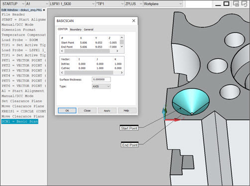

To find a Low/High point in an area, select Insert | Scan | Center. The CENTER tab in the BASICSCAN dialog box appears:
BASICSCAN dialog box - CENTER tab
This tab takes a start point of the scan and an end point and enables the controller to execute the scan. The output from this scan is a single point only.
For the center method, you do not need to set a boundary condition on the Boundary tab.

Once you create the scan, PC-DMIS inserts it into the Edit window. Following is an example of a command line for a center basic scan in the Edit window:
SCN4 =BASICSCAN/CENTER,NUMBER OF HITS=1,SHOW HITS=NO,SHOWALLPARAMS=YES
<5.606,9.053,-3.005>,<5.606,9.053,-7.000>,CutVec=0,0,1,AXIS
InitVec=0,1,0,IN,THICKNESS=0,AVOIDANCE MOVE=NO,DISTANCE=0
FILTER/DISTANCE,2.54
EXEC MODE=RELEARN
BOUNDARY/
HITTYPE/VECTOR
NOMS MODE=MASTER
ENDSCAN
